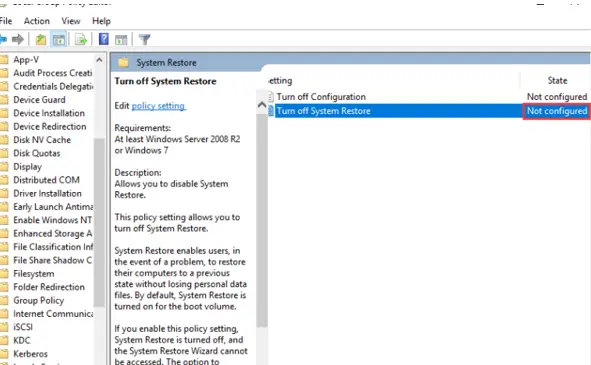

  3. Go to Computer Configuration\Administrative Template\System\System Restore.
  1. There is an option named Turn off System Restore. Set it to Not Configured.
  2. Restart your PC.
  3. This should solve the error.

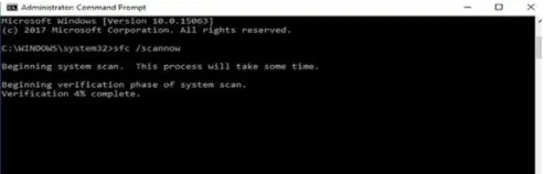

  1. Press Windows + R.
  2. Type cmd, and press ctrl + shift + enter.
  1. Type sfc /scannow, and press enter.
  2. Restart your device after the process completes.
  3. Check the results.
