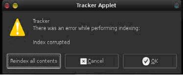

Tracker Applet- There was an error while performing indexing
Hello Guys.
I have encountering this error all day long, no matter what I am doing this error always pops up; what should I do to get rid of this one.
Any ways I am using Ubuntu, Do I need to reinstall my O.S?
Or is there any solution for this problem?
Pleas I need to get rid of this one.
Tracker Applet
Tracker
There was an error while performing indexing:
Index corrupted

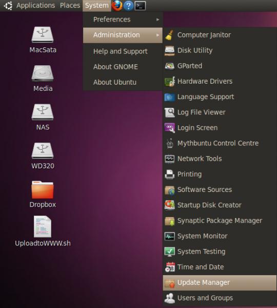

It seems that the bug has been fixed in Jaunty (version 9.04) and Karmic (version 9.10) releases of Ubuntu. I suggest you to update your packages to ensure that you have the latest tracker application. (If your system is up to date then you can skip this section. If not or you're not sure, please do the following the steps).
You can update the packages from the Update Manager application (click on System menu, then under Administration sub-menu, click on Update Manager)
Once it's opened, click on Check, type in your administrator's password, wait until it checks for new packages (if any), then click Update.

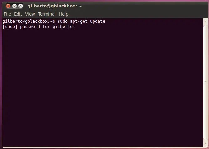

Alternatively, you can use the Terminal application to update your packages (click on Applications menu, then under Accessories sub-menu click on Terminal):
Once it's opened, type the following to check for updates:
sudo apt-get update
When prompted, type in your administrator's password. Once it's finished, type the following to install the updates:
sudo apt-get upgrade
Just wait until it finishes and then try to reproduce the tracker's error.

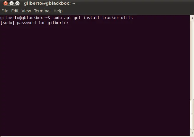

If your system is up to date and the problem persist, then we're going to install the tracker-utils package (if not installed) and then reset the tracker process. To install the tracker-utils package, open the Terminal (click on Applications menu, then under Accessories sub-menu click on Terminal). And type:
sudo apt-get install tracker-utils
When prompted, type in your administrator's password. Once it's finished, type the following to reset the tracker process:
tracker-processes -r
And this should fix the problem. Let me know if you need any further help.
