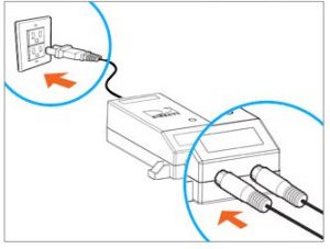

When you are finished, turn on your TV then see if it works. If this doesn’t work, next to check is the Swim power inserter. The majority of DIRECTV users also have this in addition to their satellite dish and DIRECTV receiver. The Swim power inserters need to be connected to a power outlet to work. They are connected to the cables going towards the DIRECTV satellite dish.
If your DIRECTV comes with Swim power inserter, verify that it is plugged in to a power outlet and it is turned on and working. If it is turned on and working, try doing a power cycle to fix the error. Unplug the Swim power inserter from the power outlet then wait about thirty seconds (30). After this, plug it back to the power and turn it on.
