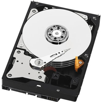

If you have a laptop and you hear continuous clicking sounds, it definitely doesn’t come from the cooling fan because cooling fans don’t create clicking sounds. Clicking sounds normally come from hard drives and when you hear this, you need to be alarmed. When a hard drive starts clicking or creates clicking sounds, it is a sign of an impending failure.
Normally, a few clicks aren’t that bad. Your computer probably just hit a bad area on the hard drive or a bad sector. Though this might cause your computer to freeze, it can still be fixed by running a disk utility application like CHKDSK. But if the clicking seems to be continuous, you need to back up your data on a separate drive because your hard drive is definitely failing.
It’s hard to tell when will the drive stops working. After backing up your data, you need to replace your hard drive with a new one. You cannot fix a failing hard drive.
