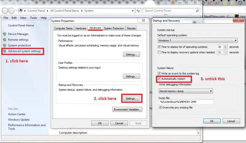

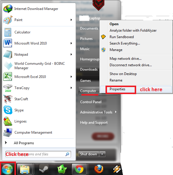

 It seems to me you might have a hardware issue here. Perhaps you finding it difficult to diagnose the problem correctly since Windows is automatically restarting your PC without showing you the appropriate error message that caused the critical fault in the first place. First is we want to isolate that Windows is not the one causing the problems here so what we do first is:
1. Click the Start orb then right-click My Computer then select Properties.
2. Click on Advanced System settings. On the Advanced tab click on Settings on the Startup and Recovery section. Finally untick the Automatically Restart on the succeeding dialog box.
Hopefully next time when your computer crashes it will display the error message that is causing it.
