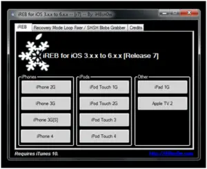

  1. Download iREB for the Windows.
  2. Use the USB cable to connect your device to the PC.
  3. Launch iREB and in the options choose the name of your device.
  4. To put your device in DFU mode:
  • Press the home button and power button together for 10 seconds.
  • After 10 seconds, keep holding the home button, iREB will detect the device.
5. iREB will confirm that the device is in DFU mode.
6. Now, leave the device connected to the PC and restore it.
