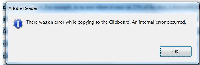

I used to read a lot with Adobe reader, I have files in Adobe. I used to copy some important lines for reference. But when I try to copy I get the following error message. This error appears only after two or three copy functions. How to find the root cause of this error? Really I am in help. I am not a technical person, please assist me solve this problem. Thanks in advance.
Adobe Reader
There was an error while coping to the Clipboard. An internal error occurred.

This problem is occurring because of something odd. This odd problem appears because of same sort of error. This problematic error is happening because of Skype add-on for Internet Explorer.
In order to fix this issue, follow as written:
1. Start Internet Explorer.
2. Go to Tools >> Manage Add-ons >> Enable or Disable Add-ons.
3. Find out “Skype” and click once to select it.
4. Below, press “Disable” button.
5. Hit “OK”.
6. Internet Explorer might restart. If prompted, press “OK”.
7. Close Internet Explorer.
This time, no more problem for sure.

This issue occurred due to a conflict with Skype Add-on on IE. To resolve this, just launch Internet Explorer and then click on Tools and go to Manage Add-ons. After that, click on Enable or Disable Add-ons and search and click Skype. Click the Disable option radio button and click OK. You may need to restart Internet Explorer, just click OK on the message and close Internet Explorer.
Alternatively, you can also try uninstalling Skype Click to Call so all the Skype Add-ons will be removed from any of your browser. For some situation, problem can be resolve simply by closing their Internet Explorer.
