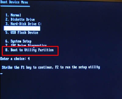

You first need to know if the drive needs to be replaced or not. To do that, remove the hard drive and re-install it back properly. You should be able to see the instructions on how to do it through your service manual.
When you have put it back, do a diagnostic. Once the computer is starting up, click F12 to open the boot menu. Then select Boot To utility Partition. Hit Enter.
The Diagnostics will now start.
Select Test System and do an Express Test.
If an error shows up that’s the signal for you to replace your drive.
If there’s none you can now enjoy using your laptop. 🙂
