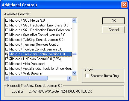

Steps to use TreeView control in MS Excel:
Create a new workbook and add few formulas to worksheet 1 & 2.
Enter the Visual Basic Editor, and add a new useform to your book.
Add a new blank code module then add the code to launch the useform.
Code:
Sub ufLaunch ( )
          ‘Launch the useform
          Useform1.Show
End Sub
To add TreeView control to Control Toolbox > Right-Click Toolbox >Additional Controls
Scroll the list and Check Microsoft TreeView Control Version X
This would add up TreeView Control to your Toolbox.
