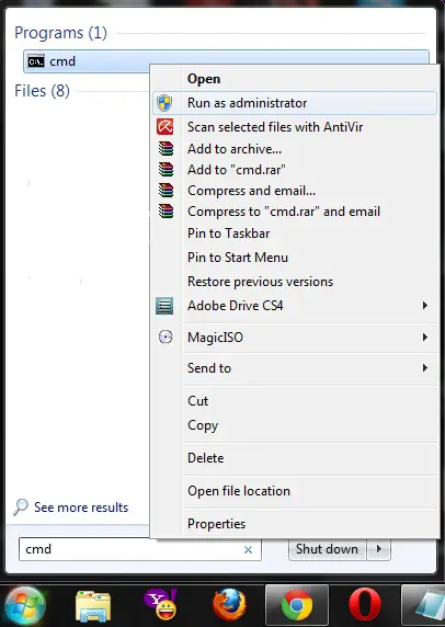

There is a possibility of out dated drivers. As you have already mentioned above that you are receiving the same error while installing the program. Well you do not have to worry about this problem. What you need to do is just to follow these steps:
1. Click on the start button.
2. In the "Search" field, type CMD and hit enter.
3. After that open the CMD as Administrator by right clicking on it and selecting "Run as Administrator".
4. Once the Command Prompt is open, type "subset G: C:" (Without inverted commas)
5. After typing this, hit enter.
Your problem is solved now. You can easily install the program that was giving you error before.

Click on START button, type in CMD.  You will now see the command prompt icon. Right click the icon and choose run as administrator. Now in the command prompt type in subset G: C: and press enter. Install your mouse driver again. I hope this helps.
