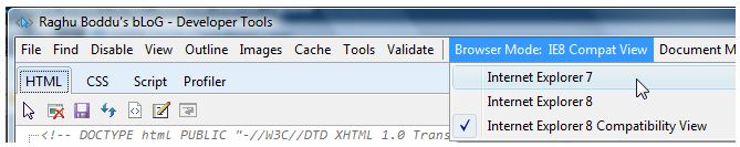

See the image below to be able to learn more:
There are websites that is still not compatible with Internet Explorer 8. This may caused by Java Script and or other add-ons needed to make the website works properly.
Adobe Flash Player also is the possible caused because it needs this software running up to date. Do check the website using the other browser and if this works with Google Chrome, Firefox and or other type of browser then Internet Explorer 8 needs to be investigated.
