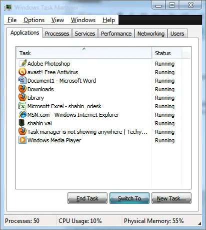

It seems that my task manager has vanished from the chart.
I used to get it by pressing (Ctrl+Alt+Del) configuration or by right clicking on the task bar.
Now none of them are showing it, and I do not how to get it with any other process either.
Should someone know about this problem please help me solve this.

Problem solved! Thanks,
Tunacao_Caaron1. I followed your method 2.
I run regedit and go to HKEY_CURRENT_USER > Software Microsoft > Windows> CurrentVersion > Policies> System.
Simply, delete Disable TaskMgr.
Reboot the system.
Done! To be sure I performed a full system scan using avast, it seems that a virus caused the problem.
