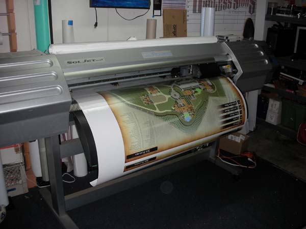

My Roland SC-545EX stops the printer head on the middle of printing job. The print head doesn’t move to its home position and stacked where the printing was stopped. There where error code displayed on the printer panel says Scan Motor Code 0010 0010 or SC 0110. Please help!

In a Roland SC-545EX printer, the Scan Motor Code 0010 refers to the Scan Motor Deviation Error. If you receive this error, the printer probably encountered a media jam, the carriage was moved by hand, the carriage runs over an object, or the media is caught on the media core.
The possible causes why this problem happened are: the cable has a cut-line, the cutter carriage has a loose drive wire attachment screw, there is a low wire tension, high scan motor hours, and broken or burned ICs on the board. To check the issue and possibly fix it:
  • Check the wire attachment screw and wire tension.
  • Move the print carriage and cutter manually and then check for any obstructions or obstacles on the linear rail or for any certain resistance.
  • Check the LH idler pulley for clicking. If there is, replace it.
  • Check the Y motor mounting screws as well as the wire condition.
  • If you hear a noise in the Y scan motor gear, loosen the attachment screws and then turn the scan motor away from the main gear. After that, check again the resistance on the linear bearing.
  • Clean the linear bearing using light duty oil.
