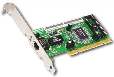

  • The motherboard port thru the CABLE wire is broke or not functioning.
Return the board if it is under warranty, if not, then find a technician in your place that can fix the port.
Or you can buy a LAN CARD in COMPUTER SALES as shown below.
