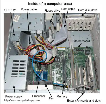

Solution 1:
Open your CPU
Unplug/plug the hard disk and reboot

Unplug/plug the devices on your CPU if your PC is out of warranty only.
