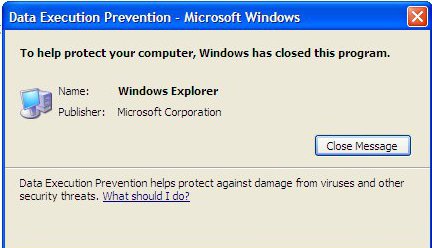

When I am try to shut down my pc, by clicking on the “Turn of Computer” button a box pops up with error “Data Execution Prevention” and ask if i want to send an error report or not , this happens every time i try to shutdown my pc, anyone knows why this is happening?
Here is a screenshot:
Data Execution prevention – Microsoft Windows
To help protect your computer, Windows has closed this program.

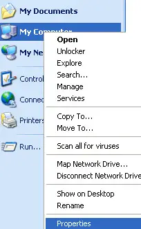

Data Execution Prevention dialog box mostly appears when it’s prohibiting or stopping any viruses or threats that might damage your computer. You can aid this message box from popping up by simply turning it off.
Go to “Start” main menu tab then click “My computer”  and select “Properties”

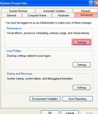

Find  and then click  “Advanced” icon in the “System Properties”
Now in the  “Performance” options  press “Settings” (below, 1st  image)

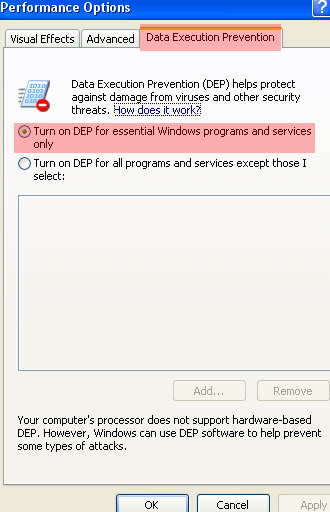

Press “Data Execution Prevention” once you see it appeared right after “Performance Options” tab. Then secured to select the "Turn on DEP for essential Windows programs and services only”
(below, 2nd image)
To close the windows screen just simply press down “Ok”
To finish the process restart the computer.
