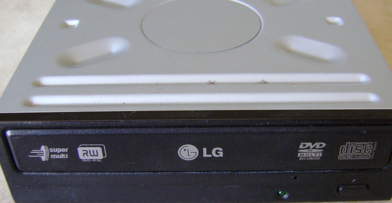

Watching DVD movies is my hobby and I love to play it on my computer which has a wider screen compared to my laptop. I’ve been doing this as a past time when I don’t have anything to do every summer.
Well, when I checked it today the DVD drive won’t open. I tried to push the button several times so that it will open and I even waited for several minutes for it to rest then try to open it again. Still the same thing happened. The DVD drive won’t open and eject. Can anyone help me on this problem?
