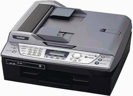

Hi! I have printer Brother DCP-330C , 2 weeks ago it started to show error "Unable to unit.51", I didn't use printer for those 2 weeks, but when I started it didn't work showing the same error. I reinstalled the drivers, disassembled the printer, checked is had paper jam (didn't have), ink, everything is good, I have no idea what is the issue.
