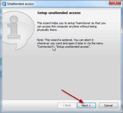

If you know the person that wants to connect to your computer, setup an unattended access. To begin, start TeamViewer then go to Connection then select “Setup unattended access”. See image.
In “Setup unattended access” screen, click Next. See image.

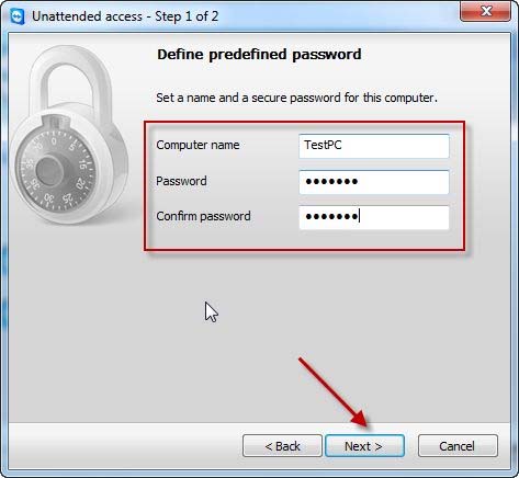

On the next screen, configure your computer and enter the information like the computer name and password. This section will require you to enter the password twice to confirm that you entered a unique or identical password. Click Next when done. See image.

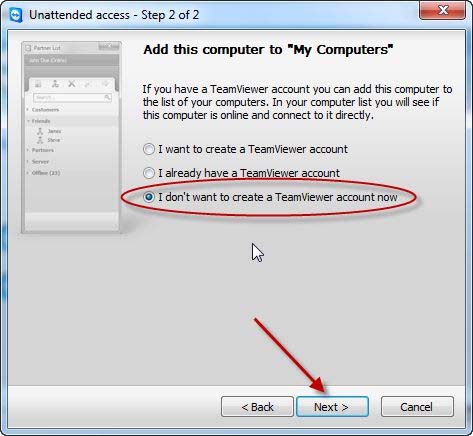

On the next screen, you can select an option to create an account if you don’t have one yet, use an existing TeamViewer account, or don’t create an account. Here, select “I don’t want to create a TeamViewer account now” and then click Next. In case you want to create an account in the future, you can always go back here and change the option. See image.

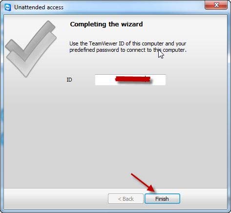

The final screen will show you your TeamViewer ID. Take note of your TeamViewer ID because you will use it for the unattended access. Click Finish to exit. See image.

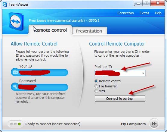

Now, to use the unattended access you just setup, enter your TeamViewer ID in Partner ID and then click “Connect to partner”. See image.

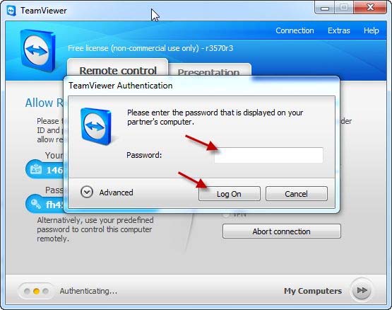

In TeamViewer Authentication dialog box, enter the password you used during the setup and then click Log On. You can also click Advanced to see other options you can use for the unattended access. See image.
