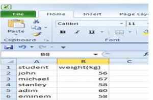

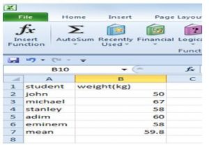

Step1. First to find the standard error calculation you need to have the mean of the values. Let’s understand this with an example.

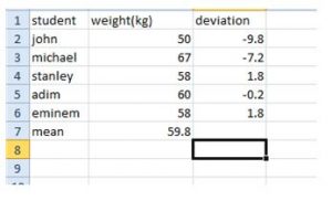

Find the mean of the entire student’s weight which in my case will be
Step2. After this step, you need to obtain the deviation by subtracting the above value from every student’s weight.
