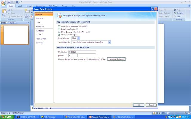

1. In the left side corner of the PowerPoint screen click “Office button”.
2. In the bottom of the window screen click “PowerPoint Options”

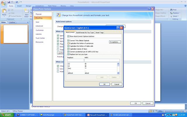

3. You can see in the options list “Proofing”, select it.
4. Click “Auto Correct” Option button.
5. Click the check mark “Capitalize first letter of sentences” In the options list to make it uncheck.
6. Then Click OK button

1) Click the Office button in the top left corner of the screen.
2) Click the PowerPoint Options button in the bottom of the window.
3) Select Proofing in the list of options.
4) Click the AutoCorrect Options button.
5) Remove the check mark from the option Capitalize first letter of sentences.
6) Click the OK button.
That's it. From now on, any new line of text will not be "corrected" to begin with a capital letter.

If we want to stop Capitalization Firstly, we have to open PowerPoint because without open we can't solve it. So, open the PowerPoint and try to stop Capitalization by following this term. I think it will easy for us if we understand well. Click the office bar from PowerPoint after that click PowerPoint Option's.
After click PowerPoint Option's we get some option. we have to select Proofing tab, when we click Proofing tab we get AutoCorrect Option's and a box will of here.
From that box Click the AutoCorrect tab and withdraw mark from Capital first letter of sentences, click OK and again click OK to return to PowerPoint. I think we can solve our Capitalization problem by following this term.
