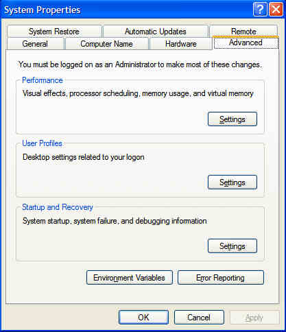

  5. After the deleting again go to Start menu and go to icon of My Computer and right click it and choose the option of Properties.
  6. Go to the Tab of Advance and choose the Startup and Recovery then go their settings and you will see its dialog box.
  7. In the startup of system choose the option of Edit and change the file of boot.ini
