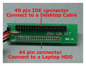

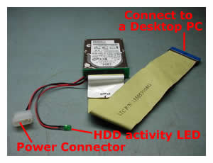

First  you have to connect your laptop hard drive with your  desktop computer by using a adopter which is called Laptop IDE Hard Drive Adaptor. This adopter is helpful if a laptop hard drive has failed and recover data from it.
Let me know you that on a laptop hard drive there are 2 groups of pins. One group has 43 pins and the other has 4 pins. The pin 1 is located on the side closer to the group of 4 pins. when you connect your laptop IDE adapter, your desktop IDE cable and your laptop hard drive to each other, make sure to connect pin 1 on the hard drive, pin 1 on the desktop IDE cable to pin 1 on the adapter. On a desktop IDE cable the side painted in red goes to pin 1.
After you have assembled everything together, Please connect the IDE cable to a desktop PC safely. You need to connect it to a free IDE connector on the system board. When you start your computer, you should see the laptop drive in BIOS and in Windows. You can treat this drive as a regular hard drive.
For you better understanding.. I have attached some photos.  .. I think it will help you.
