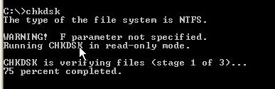

There can be some voltage error in your area which can damage your hard disk. May be there is some error in your power supply. So you need to check is that your hard disk is getting perfect power supply. If you are not a technician then consult a technical and make sure that your hard disk is getting a perfect voltage supply. Because voltage supply can damage your power supply. Also check the data bus or data cable in your computer and make sure it is working problem. Make a full scan to your computer also and make sure that there is no virus in your computer. Make a disk scan to check you hard disk by going to START and then to RUN and here type CMD and now type chkdsk and press enter. It will check your disk and will make it error free. After you go through these steps you will be more protective with your hard drive.
