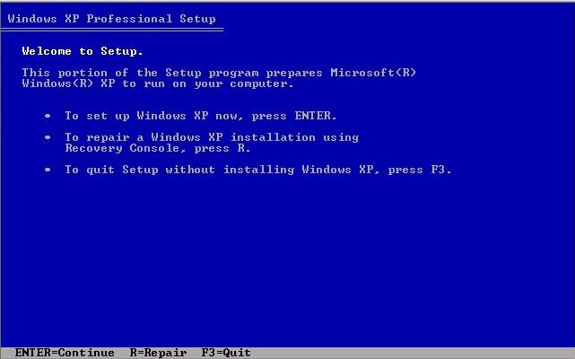

Answered By 0 points N/A #130922
Error message “NTLDR is missing”
The error that have shown indicates that your Windows has been corrupted and NTLDR is an essential file to load your Windows Operating System.
To fix the problem please follow the following simple steps.
1. Go to BIOS by restarting the computer and usually by pressing F1, F2, F10 function keys or hitting del depending on your computer. Once inside the BIOS, you need to change the primary boot option to CDROM then save and exit.
2. Insert your Windows operating system installation CD (Just like you are about to format). and follow the instructions
Note: You don't have to format
3. Assuming that you already reach these part.
4. press Enter
5. Press R and repair will start
Note*** Repair looks identical to reinstalling but repair actually recopy lost files to get your operating system up and running.
This should solve the problem
Thanks
