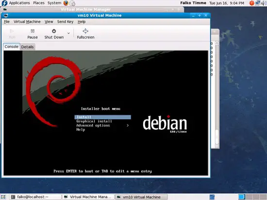

Go to File and Add a connection, when connecting to Fedora 10 KVM host.
Choose QEMU/KVM as Hypervisor, Remote tunnel over SSH as your connection in Fedora 10. Type server1.example in the hostname or set-up an IP address 192.168.0.100 of Fedora 10 KVM host.
Click connect and click OK. It'll ask for password of Fedora 10 KVM host. vm10 will be running, mark it as guest and click the open button to access the console. Type the password for KVM and you should be able to connect to the graphical console. The Debian  installer then will guide you through.
