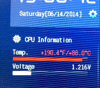

I am using a desktop that I had purchased 4 years ago. But from few months my CPU getting too hot and overheating, it is misbehaving. Then how can I fix my CPU from overheating?

CPU becomes too hot due to the faulty circuit or overclock or malfunction of the CPU fan and heat sink. When a CPU becomes too hot then it can damage the motherboard or /and nearby components over time. At the same time, excessive heat is very bad for the computer. The CPU has not failed if you can enter the BIOS setup. If your CPU had failed then you would not see anything on the screen.
You can fix your CPU from overheating by following the steps given below:
First, you unplug your computer before opening the case, consider other options first after that you remove the small CPU culling fan. Then release the CPU. You take care not to drop the processor cull it of it is stuck.
At last, you clean out the heat sink and then carefully wipe off any residual thermal paste. Finally, you fixed your CPU from heating.

If you are using a desktop computer and you experience a lot of overheating where the CPU shuts down automatically, you have to replace the CPU cooling fan. There are one or more cooling fans installed on the CPU case but the most crucial one is the one installed on top of the processor, the one placed on top of the heat sink.
This is the main cooling fan that makes the processor not to overheat. If your computer always turns off by itself because of overheating, you have to replace the CPU cooling fan. If you don’t know how to look for a compatible cooling fan for your processor, you can bring it to a computer shop or computer store to help you find a suitable cooling fan for your CPU.
Also, if overclocking is enabled on your CPU, you have to disable it. You have to disable any overclocking method running on your computer because this is the main source of overheating. When you overclock a processor, its clock speed goes beyond the factory default and the heat it produces is much higher than with normal operation which the default cooling fan may no longer support.
Users who overclock their CPUs always replace their cooling effects.
