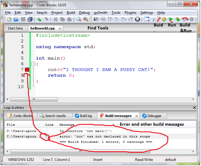

I think your problem is resolved. Since you said that you found code blocks in the repository, then I guess your distro satisfies the requirement stated by Marcus. Here is a screenshot to help you out with the IDE.
Code blocks in the repository
