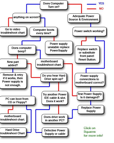

Hi there,
The first thing I'd like to say is – it's great when you can make a diagnosis by yourself, but no matter how many questions you answer, or how big the questionnaire is, the experience is the key to successfully repairing your computer, so you should definitely double check your diagnosis with the experts.
I will provide you two flow charts, hopefully, they'll help you to solve the problems:

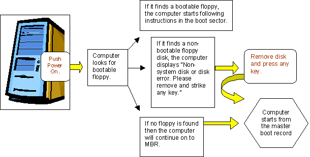

Computer turns on, performs the POST (power-on self test), The BIOS then loads the MBR (Master Boot Record) into memory, OS starts assuming that there's no error. This is a basic Boot Sequence Process.

Following flowchart will answer all your questions regarding boot proces.
Use this link as well to understand more
http://openbookproject.net/courses/intro2ict/hardware/booting.html
Flowchart of Computer Boot Process-

This is the "Computer boot-up troubleshoot Flowchart"
This flow chart shows how computers boot up.  See the below image.

Where can I know about the flow chart when computer booting?
It’s very hard to repair PC by seeing flow chart. It’s better to see the problem and troubleshoot the problem by searching in the web. Though I am providing you an image which will explain the flow chart of booting.
