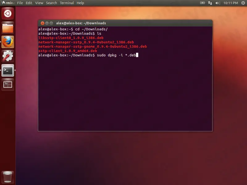

You need to install the .DEB files using dpkg
Download your files in the .deb format and put them in the ~/Downloads folder.
Run the following commands in a terminal to install the .deb files
cd ~/Downloads
sudo dpkg -i *.deb
sudo apt-get install-f

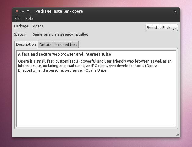

Install .deb files using Gdebi
Install Gdebi
sudo apt-get install gdebi-gdebi core
You can then right click a .deb file and select "Open with Gdebi Package Installer"
You can set Gdebi as the default for installing .deb files instead of Ubuntu Software. Right-click on a .deb file, select "Properties". Go to "Open with" tab and select "Gdebi package installer" other than "Ubuntu"

You can install it using dpkg:
Assuming you have downloaded the .deb in your ~/Downloads folder, run the following commands in a terminal to install all the .deb files:
cd ~/Downloads
sudo dpkg -i *.deb
sudo apt-get install -f
Or use Gdebi. Install Gdebi first:
sudo apt-get install gdebi gdebi-core
Right click a .deb file and choose Open with Gdebi Package Installer.

I had also faced the same error. But luckily i succeeded to solve the problem. Well if you are facing difficulty while installing .deb file from Ubuntu software then there are some other ways with which you can install .deb file.
First method is "Use DPKG to install .deb file".
Let us assume that .deb file is downloaded in your "Downloads folder". Now we have to enter a command in terminal to successfully install the .deb files.
cd ~/Downloads
sudo dpkg -i *.deb
Method 2:Use Gdebi to install .deb files"
First of all install the Gdebi. After installing it, right click on the .deb file and select open with Gdebi package installer.
Your problem is solved.
