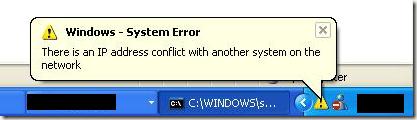

I have attached three new desktop computers with the existing small LAN of my office’s computer network. After configuring the computers, I have seen an error message from two of these computers. The messages are
Windows – System Error
The system has detected an IP address conflict with another system on the network. Network operation on this system may be disrupted as a result. More details are available in the system event log. Consult your network administrator immediately to resolve the conflict.

This happens when IP addresses are statically assigned on a network.  You probably assigned the same IP address to both computers.  Change the IP address of one of the machines taking care that it does not get the same address as any of the other computers connected to the LAN.  Or, if there is a DHCP server, enable DHCP on all 3 computers.
Here's some suggestions if you are the one maintaining the LAN:
1. Check all IP addresses on you LAN (how small is it?).  List all the IP addresses and make sure no 2 machines are given the same IP address.  This can be tedious and time-consuming depending on the size of your LAN.  You have to keep that record and update it every time a new machine is added to your LAN.
2. Instead of doing it manually, you could set up a DHCP server on your LAN.  Dynamic Host Configuration Protocol is for assigning IP addresses dynamically to machines connected to a network.  With a DHCP server, you don't have to manually keep track of all IP addresses on your network.
Hope this helps!

  • Ever get the following message when turning on your computer or taking it out of sleep mode?
  • There is an IP address conflict with another system on the network.
  • You may also see a different error message for the same problem.
  • This IP address is already in use on the network. Please reconfigure a different IP address.
  • This occurs when two computers on the same LAN network end up with the same IP address. When this occurs, both computers end up not being able to connect to network resources or perform other network operations.
This problem, though rare, can occur because of the following reasons:
  • Two computers are assigned the same static IP addresses.
  • One computer is assigned a static IP address that falls into the DHCP range for the local network and the same address is assigned to a computer by the DHCP server.
  • A laptop is put into sleep mode and then turned on while connected to another network that uses the same IP address.
  • If you have multiple network adapters, it is possible to have an IP address conflict with itself.
