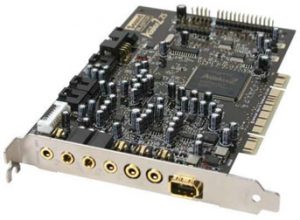

Since you are using a Dell computer and the problem is with the audio, make sure the sound card is activated or enabled in the BIOS. I am also using a Dell computer, Dell OptiPlex GX260, and I am using the built-in sound card. If the sound card is disabled in the BIOS, the volume icon or control in the system tray will vanish or is not accessible.
Sound card PCI
Even if the sound card is functioning correctly, if you disabled it in the BIOS, everything related to audio will disappear. To bring back the volume control icon in the system tray, enable the sound card in the BIOS. Restart your computer and press F2 in the POST screen to go to the BIOS. Go to the integrated devices section and turn on the sound card.
Once it is activated, press ESC then select “Save.” See if this works. If the problem with the built-in sound card continues, buy a new sound card. It is better to use a dedicated sound card than to use the built-in device. This should fix the problem with the audio.
