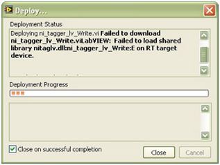

Why is that when I run my Real Time project, I get an error related to ‘ni_tagger’. Guys, please provide me a solution to fix this problem. I attached here a jpeg of the error message.
Thanks in advance.
Real Time project-ni_tagger error
Deploy…
Deployment Status
Deploying ni_tagger_lv_Write.vi Failed to download
ni_tagger_lv_Write.viLabVIEW: Failed to load shared
library nitaglv.dll:ni_tagger_lv_Write:E on RT target
device.

Dear Eharper,
When you use Shared Variables on a real time target, you need to install first the Shared Variable software components which I think you didn't and because of that you received this error message.
You need to install the Network Variable Engine (one of the Shared Variables components) if you wish to host shared variables on your real time target. In order to install Shared Variable components please follow these instructions:
  • Open the "Measurement and Automation" Explorer.
  • Under "Remote Systems", find your real time component.
  • Expand your real time component and right click "Software".
  • Select "Add/Remove software".
  • Install the "Network Variable Engine" component or both the components if you like to do.
Hope this may help you.
