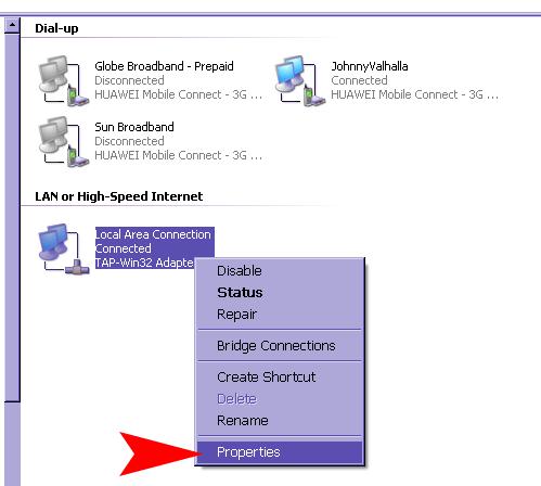

  2. Click Network and Internet Connections then Network Connections.

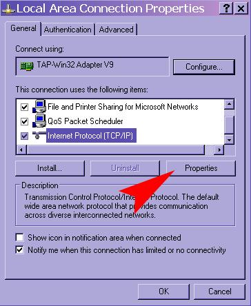

Select an available connection like in the example below. Right-click it then select Properties.

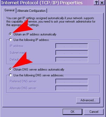

Select Internet Protocol (TCP/IP) then click Properties.
 Under General tab, select Obtain an IP address automatically and Obtain DNS server address automatically and then click OK all through out .
