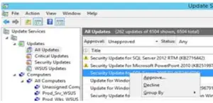

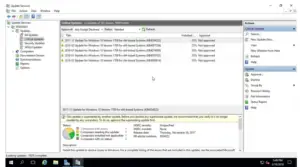

First and foremost, open the WSUS console and select “Updates” from the left panel.

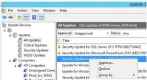

Here, you can find a specific update from the variety of categories shown. Spot the patch you want to approve, right-click on it and select “Approve.” In case you wish to decline the update, hit “Decline”.
There! You have approved a patch in WSUS.
