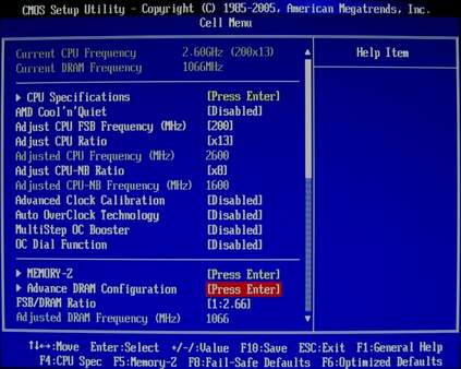

Overclocking is actually all about getting better performance, when a company releases a piece of hardware with a specification sheet usually that is not actually the maximum specification of that hardware rather its the optimum specifications for that hardware regarding lifetime, stability, heat dissipation and maybe price too. But usually there is hidden potentials that you can unleash.
Overclocking mainly depends on the motherboard you have and the BIOS. some companies try to make it harder to overclock processor, RAM, VGA while others do not mind making the process easier. so if you want to over clock your processor here are the steps :
1) You need to know the type of Motherboard you have to see the possibility of overclocking your processor.
2) Enter setup while the computer is starting (usually by pressing DEL).
3) Find the advanced settings tab ( usually its in this tab ).
4) When overclocking a processor the frequency is actually expressed as the multiple of two values (BASE * MULTIPLIER) for example:
The BASE here is 200 & the MULTIPLIER 13 giving 200*13 = 2600MHz = 2.6GHz
5) Changing either values increases your processor Frequency so giving more performance.
There is also another ways to overclock your processor by means of software, there is actually an official tool for AMD which is AMD Overdrive.
NOTE: When you overclock your processor it usually needs more powerful cooling system because its running on a higher frequency and producing a lot more heat, so a better cooling system is a must.
