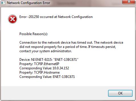

I want to configure my network device WLS-9163. I want the configuration to be set with both wired and wireless options. I completed this setup successfully and both are linked to the local network. After the successful completion of the setup, when I disconnect the Ethernet connection, an error window pops up on the screen which displays the network configuration error. The screenshot is attached below:
What does this error number mean?
Any idea related to the issue will be highly appreciated.
Thanks and best wishes
Judy
Network Configuration Error
Possible Reason(s):
Measurements: Connection to the network device has timed out. The network device did not respond
Properly for a period of time. If timeouts persist, contact your system administrator.
Device: NI WLS-9215: "WLS-139BCF2"
Property: TCPIP. Wireless IP
Corresponding Value: 169.254.92.242
Property:TCPIP.Hostname
Corresponding Value: WLS-139BCF2

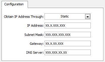

3. Configure the devices Static IP address in MAX.
Note: please record the information for future use.
Obtain IP Address Through Static

5. Then connect the MAX to the device which in Static IP Address. The error will pop up.
Network Configuration error
