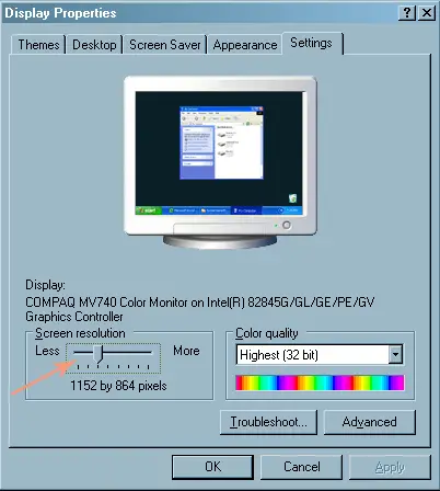

To check or change your screen resolution, click Start, Control Panel, “Appearance and Themes”, and then select Display. Select Settings tab. On the left, check what is displayed under the slider. To adjust your screen resolution, move the slider either left or right.
If your screen resolution is set within the limits, check if it is in High Color or True Color. High color is 16-bit while true color is 32-bit. If your screen resolution is set to use the true color or 32-bit, try shifting to high color or 16-bit which what is indicated in the system requirements.
