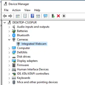

If no app is obstructing the camera, update the drivers using the steps below –
a. Right-click on the start menu.
b. Open Device Manager.
c. Click on Imaging Devices/ Camera.
d. Select your Webcam.
e. Right-click on it.
e. Click on Update driver.
f. Select the Browse my computer option.
g. Click on the option that says “Let me pick from a list of device drivers on my computer.”
h. Tick the “Show Compatible hardware” option.
i. Select the video device.
j. Click on Next.
k. Complete the process.
l. Restart your device.
m. Launch the camera.
