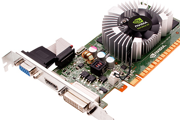

Since the problem is related to a dedicated video card, try updating its driver first to see if there is a problem with the driver. For NVIDIA GeForce GT 650M, download the NVIDIA GeForce Game Ready Driver. It supports 64-bit Windows 7, Windows 8, and Windows 8.1.
NVIDIA GeForce GT 650M video card
This driver supports GeForce 400M series, GeForce 500M series, GeForce 600M series, GeForce 700M series, GeForce 800M series, GeForce 900M series, and GeForce 10 series. Uninstall the current driver of your NVIDIA video card and install this one. See if it works. If this doesn’t fix the problem, try cleaning the pins of the video card. Shut down your computer and open the CPU case.
Disconnect the NVIDIA video card from the slot then get an ordinary pencil eraser and rub it on the contact pins of the device as if you are erasing something on the pins. Do it on both sides of the pins and finish it off with a soft clean cloth. When you are finished, install the video card back in the slot and start the computer.
See if the video card works after cleaning the contacting pins. If the problem continues, you probably need to replace the video card with a new one or just use the built-in Intel video card on your motherboard.
