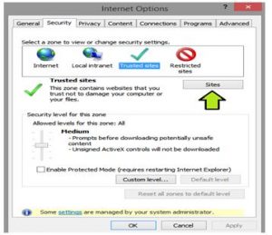

Solution2. The problem might be with your certificate.
Step1. Open internet explorer browser then selects internet option.
Step2. Select the security tab.
Step3. Choose trusted site and then click on Sites button.

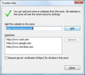

Step4. Select the URL box, and type the complete address.
Step5. Click on Add, and then close.
