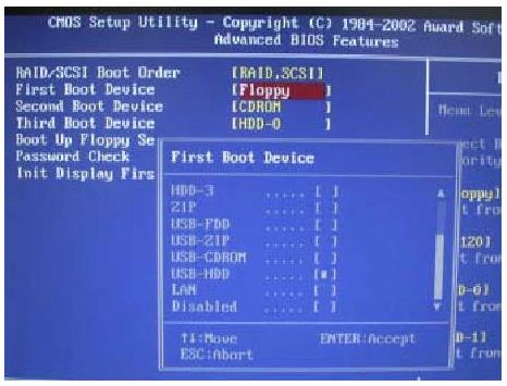

Hello, I have a pentium IV computer.
i want to install windows xp but i can't do it.
when i on my pc it goes auto boot menu and when i setup boot it shows me this message "Turn off Power and Reinstall The Jumper In Normal Mode". I check my CPU connection all are okay but still show me this message.so please tell me what can i do now?
