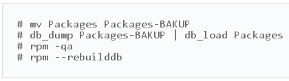

If your RPM database got suddenly corrupted for no reason, here’s how you can fix it. Take note: it is not always possible to fix errors in an RPM database especially if you don’t have a backup of your database. But sometimes it is possible. You should have rpmdb tools installed.
First, bring your system to single-user mode to prevent further damage to the database and also this makes the backup or restore process easy. Next, you need to remove “/var/lib/rpm/__db*” files to prevent stale locks. To do this, do the following:
After this, rebuild the RPM database:
See if you are still getting any errors after this. In case this doesn’t fix the problem and you are still getting errors, try the following commands if they’ll work:
For further help on repairing RPM database, visit RPM DB Recovery on RHEL 3.
