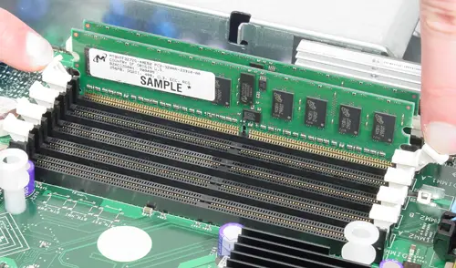

Another reason why your PC is shutting down is because you have a defective RAM, try taking your RAM off and clean the slots of dust and the RAM by gently rubbing an eraser to its gold strip, and then return it to its slot.

If you know how to connect and disconnect devices inside, here’s how to troubleshoot this problem. Unplug your CPU from the power then open your CPU case. Remove the memory card modules from the memory slot then install them back interchangeably. If you have only one memory module, connect it to a different memory slot different from where it was originally installed.
Plug your CPU back to the power and start it. See if it beeps again. If the CPU still beeps, disconnect all devices installed on your motherboard like the memory card module, video card (if you have a dedicated video card installed), sound card, and network adapter. Once all devices have been removed, install them back one at a time beginning with the memory module.
Start the CPU every time a device is installed back to test it then continue installing the next device and so on. In my experience, the usual culprit of a beeping CPU is the memory card module.
