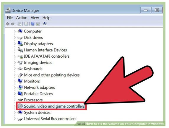

3) REINSTALL THE AUDIO DRIVERS
• Press ‘start button + R key’. Run dialog box will open.
• Type devmgmt.msc. You will be redirected to device manager.
• Select sound, video and game controllers.
• Select your audio device. If it is not working then there will be ‘!’ or ‘?’ displayed.
• Go to the driver tab and click update driver.
• Click on Browse my computer for driver software.
• Click on the INF file.
• Restart your computer.
• Your audio drivers are installed and now check for the sound.
