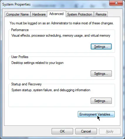

On the right pane, look for “ADSKFLEX_LICENSE_FILE”, right-click it, and select “Delete”. After this, close the “Registry Editor” window then click “Start”, “Control Panel”, and then set the view to “Small icons” on the upper right corner of the screen. Next, click “System” then select “Advanced system settings” on the left pane. In “System Properties” dialog, in “Advanced” tab, click “Environment Variables” at the bottom.

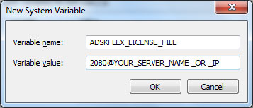

In “Environment Variables” dialog, under “System variables” section, click “New”. In “New System Variable” dialog, enter without quotes “ADSKFLEX_LICENSE_FILE” for the variable name and “2080@YOUR_SERVER_NAME _OR _IP” for the variable value. Click “OK” all throughout. See if this works.
If the license is timing out, add the following in the system variables:
