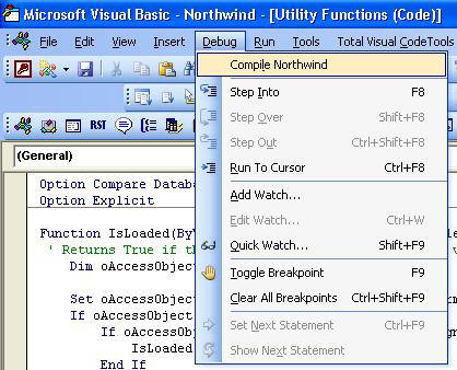

Hi White,
You are getting this compile error because there are multiple procedures with the same name. You need to check if the duplicates are the same and delete the unwanted procedure. Find the first procedure and delete it. Then, click the Debug menu > Compile <database name>. On the file menu click close. The code should run fine after you do this.
