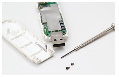

 –>First, remove the outer casing of USB using the screwdriver.
 Carefully see the solder pads and circuit board using magnifying glass.

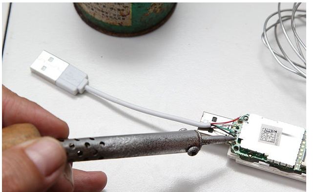

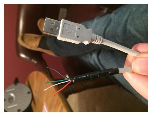

 Cut one end of another USB cable with the help of cutters.
 Solder the four wires in the cable to the solder pad of your broken pen drive.

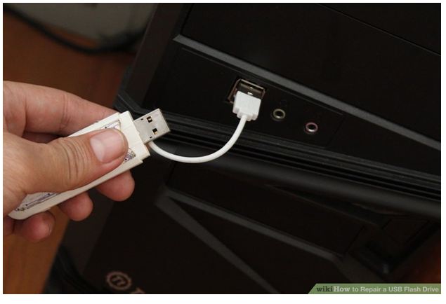

 Then connect the USB cable to a computer. Through this, you can now access your broken pen drive and save them to your  PC.
