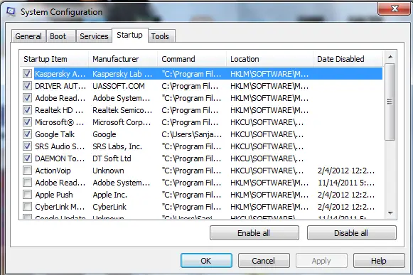

Go to start and then click run or just press winkey + r and then type ms configure and then select startup and remove all unused applications and other excluding your antivirus and all.
I have attached a screenshot on how i kept control of it.
Hope that solves your issue.
