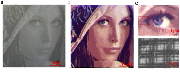

According to what researchers in Singapore have found out, it is possible to create high-resolution color images that are a number of times sharper compared to the typical methods by the use of a metal-laced nanometer framework.
The typical inkjet as well as the laser jet printers has the capability to reel out up to 10,000 dots for every inch, but the Nanotech-based technique has been estimated to reach a limit of around 100,000 dpi.
The method used is somewhat similar to lithography as opposed to the normal modern printing, and if possible it could lead to future high-resolution reflective color displays as well as high-density optical storage.

A research that has been done in Singapore suggests that we are able to print using 100,000 dpi.
And this technology is based on Nanotech. Which limits it 100,000 DPI.
This could be the future of high resolution printing. And color displays.
